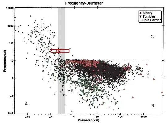

If you were 1000km south of Chixculub, it would stay fairly constantly thumb sized for 10-20 seconds as it arrived from the South-East at 60 degrees, and in that time it would travel from 1500km above to 1000km on the horizon. The graph suggests it had a rotation period of about 2 to 10 seconds, so it would have revolved noticeably.
