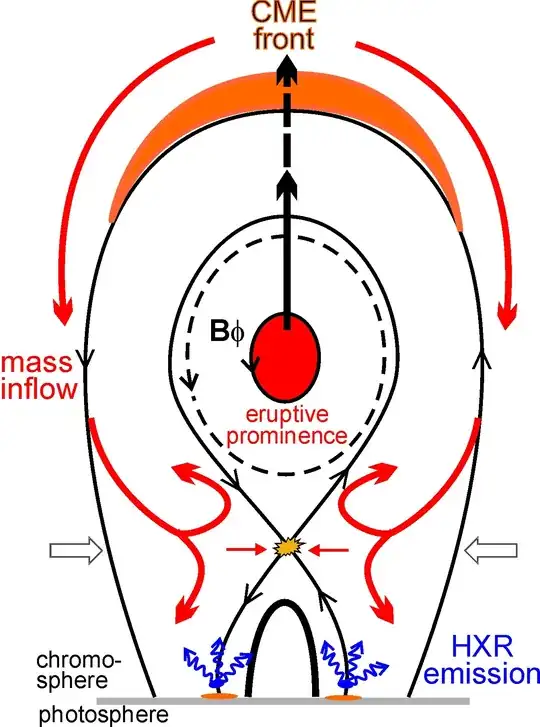

  • Magnetic reconnection mechanism: magnetic field lines are tied to the surface of the Sun and even when the plasma moves, they stay tied to their original position (their "foot points"); therefore, plasma movements can drag the magnetic field lines and entangled them in geometries such as loops, that can eventually "reconnect". "Reconnection" corresponds to a modification of the field line topology (see the image that pictures it better than my words). During this process, heat and energy are released quite efficiently.
Black lines represent the magnetic field lines. They are tied to the surface of the Sun (the foot points). One of the magnetic field lines is looping, and it is "crossing itself". When it reconnects, it forms, on the top, a magnetic loop and, on the bottom, an magnetic arch. As pointed out by this diagram, magnetic reconnection mechanism is also associated to Coronal Mass Ejection (CME), since the energy released by magnetic reconnection is powerful enough to eject a significant amount of matter.
