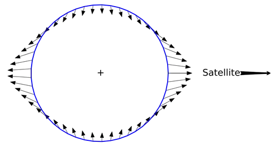

What does this look like?
The overall effect, (noted in the other answer), is an unusually high lunar apsidal precession of just 8.85 years, or just over 118 sidereal (or Kepler) orbits.
This means is that the Moon's apogee and perigee shift about 3 degrees for each lunar orbit. The Moon can't settle into a consistent orbit because of the solar gravitation acting upon it, and the tidal force on the Earth-Moon system is significant.
The Earth, for comparison, has an apsidal precession, mostly driven by Jupiter and Saturn, of about 112,000 years, or 112,000 orbits. That's about a thousand times less angular change per orbit. As a sidebar, the objects inside the orbit, Venus for example, don't have much effect on Earth's orbit. It's the outer planets that primarily drive apsidal precession. Neptune, for example, has no outer-planets to speak of, and if planet 9 is found, it would be too far away, so Neptune's orbit is nearly circular.
