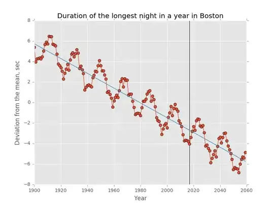

By looking at the link provided by James K, I was able to write a Python 3 script that calculates the duration of the longest night for a predefined location (Boston, MA) for 160 years. The script uses the PyEphem module. The longest night becomes shorter by ~72 msec per year, and its length also oscillates with the period of ~19 years.
Here's the script that I used:

DYZ
  • 152
    Check your script. You have a scaling problem somewhere. You should be seeing much, much larger variations than that (e.g., 32.6 seconds variation for Dec 1911 versus Dec 2035 for Anchorage Alaska). That said, you are picking up two key attributes: An apparent secular trend due to the slow change in the Earth's axial tilt, and a cyclical variation of 18.6 years. – David Hammen Dec 23 '17 at 03:55
  • From time to time, when it is directly related to supporting an answer, a python script has been included in this site with out adverse effects. – uhoh Dec 23 '17 at 04:21
    @davidhammen What is the cyclical variation due to? – DYZ Dec 23 '17 at 06:49
  • @DYZ - The 18.6 lunar nodal cycle. See my answer. – David Hammen Dec 23 '17 at 17:08
  • @DavidHammen I had a scaling issue, indeed (forgot to convert days to seconds). – DYZ Dec 23 '17 at 18:31

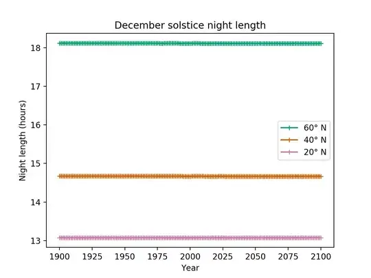

It appears to be quite constant when viewed on a coarse enough scale:
Lengths of the winter solstice night from 1900 to 2100, at 60, 40, and 20 degrees north latitude. The three curves look rather flat, with over 18 hours of darkness at 60 degrees, over 14.5 hours at 40 degrees, and a bit over 13 hours at 20 degrees.

Over the very long term (a hundred thousand of years or more), the Earth's rotation rate is getting slower. This is a true secular trend that will eventually result in increases in the lengths of both the day and the night on the day of the year with the least daylight of the year, regardless of other effects.
This very slow secular increase is counteracted or exacerbated by cyclical effects. One is the Earth's axial tilt. This varies cyclically, but with a period of 41000 years. Over the short term (hundreds of years is short in this context), the effects of changing axial tilt are much stronger than are the effects of the secular increase in the length of day. The Earth is currently in a phase where the axial tilt is decreasing. This makes the length of daylight increase on the "shortest day of the year", and hence makes the length of that longest night decrease.
A much shorter term cyclical effect results from the location of the Moon with respect to the Earth and Sun. The Earth and Moon together orbit the Sun. This means that when the Moon is above the plane of this orbit, the Earth will be slightly below, and vice versa. This subtly changes the lighting of the Earth. Where this occurs varies as the lunar node precesses over an 18.6 year period.
