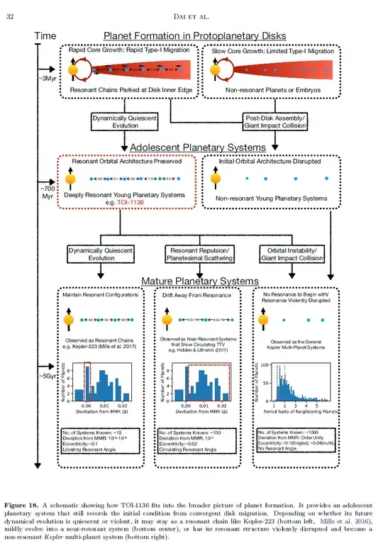

MMRs can be broken up by various mechanisms. Dai et al. list (as some of the mechanisms that break up MMR chains):
Planetesimal scattering (Chatterjee & Ford 2015), tidal dissipation (Lithwick & Wu 2012; Batygin & Morbidelli 2013a), secular chaos (Petrovich et al. 2018), and orbital instability (Pu & Wu 2015; Izidoro et al. 2017; Goldberg & Batygin 2022)
Some resonances are more easily broken in numerical simulations than others. Dai et al. performed Monte-Carlo orbital simulations of TOI-1136 with period ratios of 3:2, 2:1, 3:2, 7:5, and 3:2. In the majority of the simulations, the 7:5 resonance was the first to become disrupted. According to the authors, this is due to the second order resonance being weaker.
Gradual drift away from MMRs is probably the reason why we see many exoplanet chains with mildly degraded MMRs (10^-2 MMR deviations). In one of the papers linked in the original question, The K2-138 System: a near-resonant chain of five sub-Neptune planets discovered by citizen scientists, Christiansen et al. have ratios for the orbital periods of planets b through f as:
1.513, 1.518, 1.528 and 1.544 for the b-c, c-d, d-e, and e-f pairs respectively, just outside the 3:2 resonance
So K2-138 would sit in the bottom middle part of the above diagram, since a perfect 3:2 resonance is 1.5, so they are on the order of 10^-2 away from perfect resonance. Of course K2-138 is only estimated to be about 2.3 Gyr old, according to wikipedia, so we might expect additional departure from perfect resonance as the system ages. Christiansen et al. paraphrase another paper as to the suspected migration from perfect resonance in this system:
They offer several possible explanations for this, including gravitational scattering slightly out of resonance by the additional bodies in the system, or tidal dissipation preferentially acting to drag the inner planets inward from the resonance
Tidal dissipation acting to pull the inner planets inward I guess would imply the planets are in retrograde spin direction. If they were in prograde spin, tidal dissipation would act to push the inner planets outward. Then the period ratios would be less than 1.5, rather than greater.
Summary: Resonant chains of exoplanets naturally form in some young stellar systems as their planetary orbits gradually migrate due to angular momentum exchange with the original accretion disk. Most of these resonant chains are unstable on the order of billions of years, so they are very rare around mature stars. Of those that are near resonance, most of them vary by on the order of 10^-2 from perfect resonance. Very few are within 10^-4 of perfect resonance.
