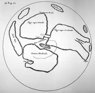

In fact, the first and last known "map of the moon" drawn purely based on naked-eye observations was drawn by William Gilbert (1540–1603) and included in his posthumously published work De Mundo Nostro Sublunari. It is quite remarkable how little detail his map actually includes, even compared to a tiny 40 by 40 pixel image as shown above:

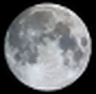

William Gilbert's map of the moon The moon, scaled down to 40 px radius and back up to 320 px
Left: William Gilbert's map of the moon, from The Galileo Project; Right: a photograph of the full moon, scaled down to 40 pixels across and back up to 320 px.

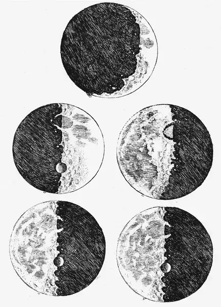

Indeed, even the sketches of the moon published by Galileo Galilei in his famous Sidereus Nuncius in 1610, notable for being based on his telescopic observations, are not much better; they show little detail except near the terminator, and the few details there are appear to be inaccurate bordering on fanciful. They are, perhaps, better regarded as "artist's impressions" than as accurate astronomical depictions:
Galileo's sketches of the moon from Sidereus Nuncius (1610)
Galileo's sketches of the moon, based on early telescopic observations, from Sidereus Nuncius (1610), via Wikimedia Commons. Few, if any, of the depicted details can be confidently matched to actual lunar features.

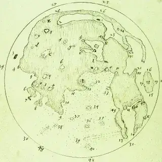

Much more accurate drawings of the moon, also based on early telescopic observations, were produced around the same time by Thomas Harriott (1560–1621), but his work remained unpublished until long after his death. Harriott's map actually starts to approach, and in some respects exceeds, the detail level of even the 60 pixel photograph above, showing e.g. the shapes of the maria relatively accurately. It is, however, to be noted that it is presumably based on extensive observations using a telescope, over several lunar cycles (allowing e.g. craters the be more clearly seen when they're close to the terminator):
Thomas Harriott's lunar map, c. 1609 The moon, scaled down to 60 px radius and back up to 320 px
Left: Thomas Harriott's lunar map, undated but probably drawn c. 1610-1613, based on early telescopic observations, quoted from Chapman, A. "A new perceived reality: Thomas Harriot's Moon maps", Astronomy & Geophysics 50(1), 2009; Right: same photograph of the full moon as above, scaled down to 60 pixels across and back up to 320 px.
Based on this historical digression, we may thus conclude that the 40 pixel image of the moon, as shown in the question above, indeed does fairly accurately represent the level of detail visible to an unaided observer, while the 60 pixel image even matches the detail level visible to an observer using a primitive telescope from the early 1600s.

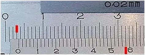

Vernier acuity is the ability to discriminate misaligned straight lines. You may be familiar with Vernier Calipers which allow measurement accuracy of one thousandth of an inch with the unaided eye. Vernier acuity far exceeds optotype acuity (and so is termed hyperacuity) and can be further improved up to 6 fold by training.
enter image description here https://en.wikipedia.org/wiki/Vernier_scale
