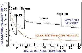

18 km/s x 31.5 million seconds in a year (close enough) is 567 million km per year. It should have taken Voyager about 33.5 years at that velocity to reach 19 billion km. However, Voyager's velocity wasn't consistent. As it flies from the sun it slows down and it had several gravity assists along the way which sped it up and changed it's direction. Mathematical calculations get a little tricky, but here's a chart of Voyager's velocity.
(Note: that's Voyager 2's velocity not Voyager 1. I'm having trouble finding Voyager 1's velocity chart).
