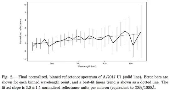

The asteroid was discovered and has been observed mostly (if not completely) by it's reflection of radiation from the Sun. The Sun is roughly a blackbody emitter and most of the radiation is in the visible. Because of the dimness of the light even at maximum, there isn't much signal once dispersed spectroscopically.
There is a spectrum published in ArXiv Palomar Optical Spectrum of Hyperbolic Near-Earth Object A/2017 U1 on 2-Nov-2017 by Joseph R. Masiero though! Despite the low light level (V ~ +21) and expanded size due to poor seeing at low elevation resulting in a signal-to-noise ratio of order unity, the 5 meter Hale telescope (200 inch Mt. Palomar) was used to try to obtain some spectroscopic information. Ten 300-second runs (total of 50 minutes of collection) were used to produce the heavily binned spectrum below. I think those are 1-sigma error bars, so the spectrum doesn't say much more than "slightly red-ish".

One lucky break came immediately after the MPC's initial announcement. Observer Joe Masiero (Jet Propulsion Laboratory) just happened be in the middle of a run with the 5-m Hale Telescope at Palomar Observatory, and he quickly obtained a spectrum that's reproduced below and explained in more detail here. There's no obvious absorption that would signify the presence of particular compounds or minerals.
But the gentle slope, increasing toward the red (right) end, suggests that `Oumuamua is not a particularly good match to objects in the Kuiper Belt (which tend to be much redder). Instead, it's the kind of spectrum that a rocky surface would exhibit after being "weathered" by long-term exposure to space radiation.
So I'd say that the answer to your question is "No", there's very little besides its orbit and light curve and approximate color that has been or probably could have been detected. With more warning, and serious interest, it's possible an observation campaign could have been organized to get more aperture area and time to make a better spectrum, but since S/N only scales as the square root of those, a lot of other observations would have had to have been rescheduled to make it happen.
