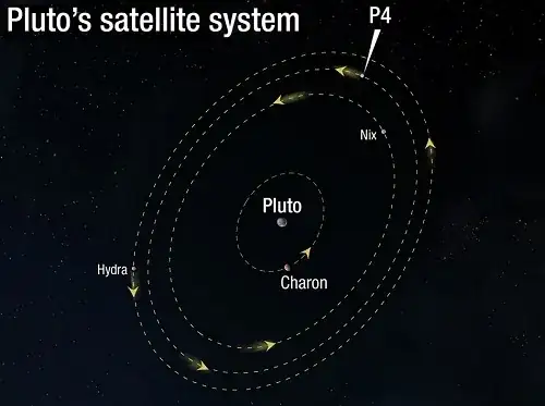

The Pluto-Charon system is similar to this.
It's unlikely that you'd have two planets of nearly the same mass because some variation is far more common, but a moon orbiting a binary planet system is certainly possible. It's easier if it's not that close to the sun, for the same reason that it's difficult for Mercury and Venus to have moons. A larger hill-sphere and less solar gravitation would make your system more stable in the long term.
And the Moon couldn't be in a Lagrange point in your system because, for starters, L1, 2 and 3 are never stable and the potentially stable Lagrange points, L4 and L5 require a large central planet and a significantly less massive object, (less than 1/26th the mass) orbiting the central planet. The L4 and L5 points are to the orbiting object. That doesn't work in a binary system of 2 objects of similar mass.
Any working Lagrange point scenario you'd have two moons and one planet, not binary planets and one moon. You could, in theory have two moons at Lagrange points to each other orbiting a binary planet system but that would be adding even more improbabilities, but theoretically possible and stable for some time.

  • Small nitpick: Is there maybe fig. 1, but with the position of the CMS of the Pluto-Charon system included? – AtmosphericPrisonEscape Sep 30 '17 at 16:28
  • @AtmosphericPrisonEscape at risk of showing my ignorance, what's CMS? – userLTK Sep 30 '17 at 17:14
  • The Center of mass system, or barycenter. I guess there's one 's' too much when you say 'CMS system', but somehow people do that. – AtmosphericPrisonEscape Sep 30 '17 at 18:29
  • @AtmosphericPrisonEscape That was my guess, I just hadn't heard it called CMS. This site seems to address it with a gif: http://mathscinotes.com/2015/06/barycenter-of-pluto-and-charon/ Pluto's distance to barycenter + Charon's distance to barycenter = pluto's distance to Charon (by center of mass, not surface). The barycenter orbital diameter ratio is also the same as their mass ratio, about 8.5 to 1. So it's a bit less than 1 Pluto radius away from Pluto's surface. – userLTK Sep 30 '17 at 20:09
