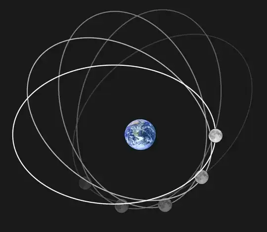

An observer on the far side of the moon would have hard time to explain it stands on a single planet, because of the movement of the most noticeable thing in the sky: the sun!
Indeed, because of the eccentricity of the moon's orbit around earth, the day length, i.e. the sun's "speed in the sky", depends on where you stand in your lunar orbit.
And from observations it can do, e.g. other planets that are nearly perfectly round in the solar system (and for well known reasons), she should be forced to rule out the "I'm standing on an elliptical single celestial body" hypothesis.
I cannot calculate the variation of day length on the far side of the moon in a reasonable amount of time, sorry about that.
Another effect I'll try to illustrate with Wikipedia images: the sun trajectory's elevation in the sky would change year after year (cycle: between 8 and 9 earthlings years), due to moon's apsidal precession and its tilted orbit plan:
By Rfassbind - Own work., Public Domain, Link
By Geologician, Homunculus 2 - from English Wikipedia, CC BY 3.0, Link
