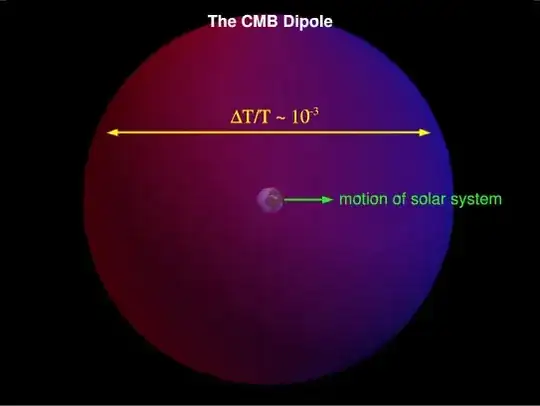

It does. When we look at the Cosmic Microwave Background Radiation we see a "dipole anisotropy" due to the motion of the Earth relative to it:
Image courtesy of William H. Kinney's Cosmology, inflation, and the physics of nothing
See Wikipedia for more:
"From the CMB data it is seen that the Local Group (the galaxy group that includes the Milky Way galaxy) appears to be moving at 627±22 km/s relative to the reference frame of the CMB (also called the CMB rest frame, or the frame of reference in which there is no motion through the CMB) in the direction of galactic longitude l = 276°±3°, b = 30°±3°.[82][83] This motion results in an anisotropy of the data (CMB appearing slightly warmer in the direction of movement than in the opposite direction).[84]"

Edit 13/09/2017 : as Dave points out in the comments, there are other motions, including the motion of the solar system around the galaxy, which is circa 514,000 mph. (See the Wikipedia Galactic Year article). And the motion of galaxies isn't neat and tidy either.

1I think this answer is confusing, because the graphic shows motion of the solar system, rather than motion of the galaxy, and the solar system moves relative to the center of mass of the galaxy. Then the answer discusses the motion of the local group, but the Milky Way moves relative to the center of mass of the local group. See the article http://iopscience.iop.org/article/10.1086/527428/meta especially the caption of Fig. 3, for more information. – DavePhD Sep 13 '17 at 14:02
1@DavePfD : noted Dave. I've edited my answer to include something on that. – John Duffield Sep 13 '17 at 16:59
