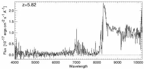

The figure below (from here) shows the spectrum of a quasar lying at a distance of 22 billion lightyears, i.e. $10\,000$ times farther away than Andromeda. You see that there are several thin absorption lines (caused by intervening hydrogen clouds whose densities are a factor of 10-100 higher than the IGM), but still most of the light makes it down to us.
qso
Because the light we see from this quasar was emitted so long ago, the Universe was considerably smaller at that time, and thus the density was larger. Nonetheless, only a small fraction is absorbed. The farther away the light is emitted, the longer ago it was, which means smaller Universe, and higher density, and thus the more light is absorbed. If you consider this quasar (from here) which lies 27 billion lightyears away, you see that much more light is absorbed in part of the spectrum. Still, however, much light make it through to us.
qso2
The reason that it is only the short wavelengths that are absorbed is quite interesting — but that's another story.

  • Do you have a link to the explanation of why only short wavelengths are absorbed? – Beta Decay Sep 12 '17 at 11:24
  • @BetaDecay: It has to do with the Lyman α transition of neutral hydrogen at 1216 Å. As light from the quasar travels through the Universe, it is redshifted. Thus, light that is initially blueward of Lyα, will at some point become Lyα. If at this point there happens to be a hydrogen cloud, it will produce an absorption line. [cont'd below] – pela Sep 12 '17 at 12:56
  • Depending on the epoch at which the quasar is observed, there may be many clouds (wiping out all light blueward of 1216 Å and producing a Gunn–Peterson trough seen in the last spectrum above), some clouds (producing the Lyman α forest seen in the first spectrum), or few clouds (transmitting most of the spectrum). – pela Sep 12 '17 at 12:56
  • Similar absorption may be seen for other transitions (e.g. Lyman β, or singly ionized metals such as Mg II or Fe II), but they will be quite a lot weaker. – pela Sep 12 '17 at 13:00
