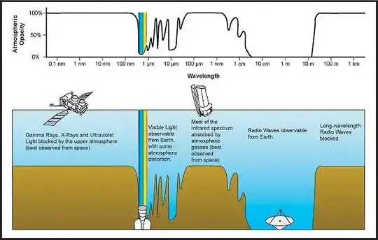

The magnitude of these Kuiper Belt Objects is incredibly small, to begin with. The atmosphere distorts stars normally and scatters light even on the clearest of nights. In addition to that, these closer objects can be found with infrared detection. The atmosphere absorbs infrared wavelengths extremely well, which makes space based observations a necessity. The Hubble telescope also detects ultraviolet, visible, and near infrared making that an ideal telescope for these small Kuiper Belt Objects.
Atmospheric absorption of various wavelengths
To deal with the atmospheric absorption, ground based telescopes such as the Subaru telescope get built on mountains so that there is less atmosphere to look through and the chance of cloud cover. However, the problem with the search for KBO was that it needed to be done in a short period of time so that New Horizons could be directed to it with less fuel. Hubble is ideal for that because it can look at the objects in the right direction all day while ground based telescopes could only do that at night assuming it is a clear enough night to see those objects. Normally Hubble is reserved for the most exclusive scientific projects and searches because of how its data quality is amazing. New Horizons had already cost so much that it was worth using a bit of time searching for its next destination instead of just ground based telescopes.

    HST is in low Earth orbit. It cannot observe objects continuously. Absorption in the visible and near-IR is of order 10-20% and has nothing to do with it. – ProfRob Sep 06 '17 at 21:20
  • Absorption does have a little to do with it, since we’re talking threshold detection, and a little bit makes the difference, – caInstrument May 10 '23 at 13:14
