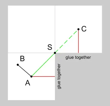

Not quite the answer but little more than a comment. Singularity, as pointed out by Stan Liou (a note about geodesic incompletness), can be understood as a point beyond which you cannot extend geodesic (shortest path between two points). This can be illustrated on conic singularity (like corner on a cube) on 2D sheet of paper.
If you pick two points on the sheet (like A and B in the figure which show part of unfolded cube), the geodesic is the shortest path connecting them, that is abscissa A-B. You can join A and the singularity (S) with geodesic, but you cannot extend it beyond S. For example, the geodesic joining A and C is the red line.
With black hole you have spacetime rather than 2D space, but you cannot extend worldline beyond singularity, it stops there.
Unfolded cube
