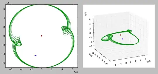

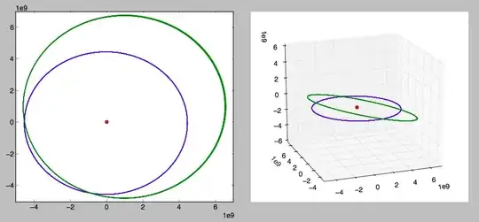

Figure 5 of that paper shows the motion of Neptune and Pluto in a rotating frame. The frame rotates with the average orbital rotation of Neptune, so over very long times you can see Neptune slowly rocks back and forth a bit:
If you like Python you can reproduce these fairly easy. The package Skyfield uses the same NASA JPL Ephemerides as the JPL Horizons site but is easier to use. You can see that 95% of this script is just making it look nicer and getting the position of the planets is just a few lines.
Here are the results for only 6,000 years, a much smaller period than shown in Cohen and Hubbard 1965, so Neptune only makes a small segment of its 25,000 cycle, near one end where it's "moving" slowly. The first set of plots are in inertial (non-rotating) J2000 ecliptic coordinates, and the second is rotating with the average orbital motion of Neptune, so that Neptune appears nearly fixed.
The first plot shows Neptune-Pluto separation versus calendar year. The minimum in this period seems to be around year -77, with a distance of 2.65 billion km or 17.73 AU.
def Rpos(pos, angle):
    x, y, z = pos
    ca, sa  = np.cos(angle), np.sin(angle)
    xr = x*ca - y*sa
    yr = y*ca + x*sa
    return np.vstack((xr, yr, z))
import numpy as np
from mpl_toolkits.mplot3d import Axes3D
from skyfield.api import Loader
loader = Loader('~/Documents/Skydata', verbose = True)
ts     = loader.timescale()
de405  = loader('de405.bsp')  # about 65 MB
de421  = loader('de421.bsp')  # about 17 MB
de422  = loader('de422.bsp')  # about 650 MB
de = de422
neptune = de['neptune barycenter']
pluto   = de['pluto barycenter']
# years   = np.arange(1600, 2201)
years   = np.arange(-2999, 3001)
time    = ts.utc(years, 1, 1) # January 1st of each calendar year
npos = neptune.at(time).ecliptic_position().km
ppos = pluto.at(time).ecliptic_position().km
npsep = np.sqrt(((npos-ppos)**2).sum(axis=0))
if True:
    plt.figure()
    plt.plot(years, npsep)
    plt.show()
aukm = 149597870.700
print "minimum separation (km): ", npsep.min()
print "minimum separation (AU): ", npsep.min()/aukm
if True:
    fig = plt.figure()
    ax1  = fig.add_subplot(1, 2, 1)
    for pos in [npos, ppos]:
        x, y, z = pos
        ax1.plot(x, y)
    ax1.plot([0], [0], 'or')
    ax1.set_xlim(-5E+09, 7E+09)
    ax1.set_ylim(-5E+09, 7E+09)
    ax2  = fig.add_subplot(1, 2, 2, projection='3d')
        x, y, z = pos
        ax2.plot(x, y, z, linewidth=1.0)
    ax2.plot([0], [0], [0], 'or')
    ax2.set_xlim(-5E+09, 7E+09)
    ax2.set_ylim(-5E+09, 7E+09)
    ax2.set_zlim(-6E+09, 6E+09)
    ax2.view_init(elev=20., azim=-110)
    plt.show()
nargperi = 276.3 * (np.pi/180.) # Neptune argument of perihelion (radians)
nT       = 164.79 # Nepture orbital period (years)
nangle   = np.arctan2(npos[1], npos[0])#  - nargperi
nangle_mean = 2.*np.pi*np.mod(years/nT, 1.0)  # this is a bit sloppy
nposr = Rpos(npos, -nangle_mean)
pposr = Rpos(ppos, -nangle_mean)
if True:
    fig = plt.figure()
    for pos in [nposr, pposr]:
        x, y, z = pos
        ax1.plot(x, y)
    ax1.set_xlim(-7E+09, 7E+09)
    ax1.set_ylim(-7E+09, 7E+09)
        x, y, z = pos
    ax2.set_xlim(-7E+09, 7E+09)
    ax2.set_ylim(-7E+09, 7E+09)
    ax2.set_zlim(-7E+09, 7E+09)
    ax2.view_init(elev=20., azim=-116)
    plt.show()
