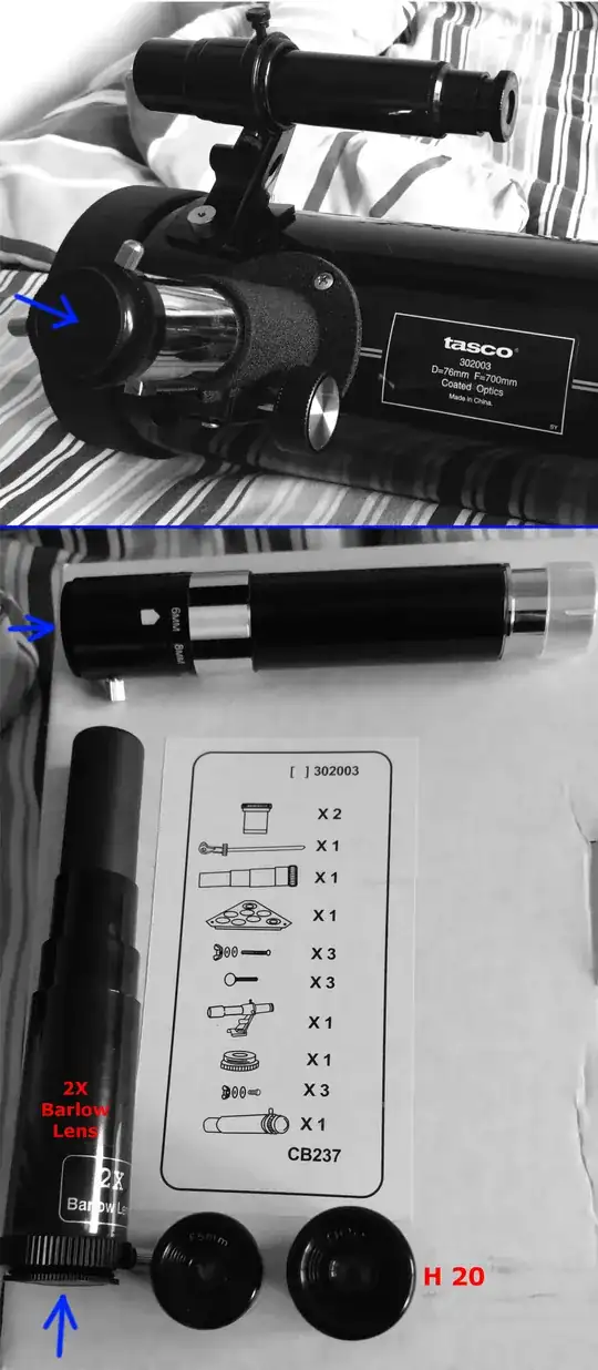

Here's a picture of my telescope and it's accessories. Despite spending the last 15 years in the back room of a charity shop, it's in brand new condition and all the parts are present including the tripod and all fixings!...
enter image description here (Blue arrows indicate places where eyepiece lenses can be inserted).

    What you need is called a T2 adapter. There are adapters for the standard 1.25" and 2" eyepiece tubes behind the focuser. They attach to your dslr (where you would usually attach the lense). The T2 adapters are brand specific though. If you have a Canon camera you need a Canon T2 adapter. Also, you won't need any "Relay lense". Just put the camera at the correct distance behind the focuser tube to get it into focus on the cameras sensor and you are good to go – RononDex Aug 22 '17 at 15:31

or you can try using a barlow lens - that replaces the last bit of the light cone with a longer, narrower angle version (which increases the magnification and moves the focal plane further out). That MAY or MAY NOT let you reach infinity focus; it's not guarenteed, but may help. You can get barlows that have a T-Thread on the output end, so you can attach a T ring directly to the barlow (yours doesn't look like one of this type) and then hook the camera up that way. (as an added benefit, since you end up with a closed tube setup (the barlow lens closes off the access to the camera, it also keeps spiders and dust out of the camera :) ).
If you have a look at the bottom bit of the barlow (with the lens) you may find that you can unscrew it. You might be able to make a short top section with a T thread for the T ring at the back, and a suitable thread for the lens at the front; you'd probably need to make it the same diameter as the eyepiece barrel (to fit in the focuser) with a fatter bit at the back for the T thread and to stop it sliding all the way into the focuser. I've used a commercial 1.25" barrel T threaded barlow (somewhat shorter than yours) for lunar and solar (WITH A SUITABLE FRONT OF SCOPE FILTER - DON'T TRY LOOKING AT THE SUN WITHOUT ONE) imaging with an APS sensor camera.
(You may need to check your scope - older ones often used a .965" barrel rather than the current 1.25" (or 2") barrel size used by most modern astro scopes.)
