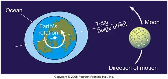

I'll use the Earth as an example, because the Earth is in the gradual process of becoming tidally locked to the Moon. It's the same process, but easier to visualize.
Because the Earth rotates faster than the Moon orbits, the tidal bulge moves ahead of the moon. This is called the tidal bulge offset.
http://pages.uoregon.edu/jimbrau/BrauImNew/Chap07/FG07_23.jpg
Source.
It's the size of the bulge and the angle of the offset (and the mass and distance of the Moon) that causes the familiar gravitational effects, the Earth's rotation slowing down and the Moon moving away from the Earth.

The current angle of offset for the Earth's tidal bulge to the Moon is about 3 degrees, often exaggerated in diagrams so it's easier to see. (I should find a source for that - I've not been able to find a good one).
From the Moon's point of view (and if we assume a circular orbit), the tidal offset stays in the same place. It's a factor of the relative rotation speed. As Earth slows down, the angle of offset will move towards zero. At tidal locking, the angle of offset becomes zero and there's no force to continue in the other direction. In a simple mathematical model, tidal locking wouldn't ever happen completely, it would just gradually get closer and closer, like an object shot from the Earth at exactly escape velocity.
In reality, because objects aren't perfectly symmetrical and because orbits aren't perfectly circular, the "take forever to get to zero", doesn't happen. But it's still a gradual approach to zero and no overshooting and returning because the force on the rotation approaches zero as the angle of offset approaches zero and the force needed to change a planet's rotation is enormous and there's essentially zero force to make that happen.
