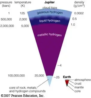

Jupiter's atmosphere, if you could see through it, the inside of the planet would begin to glow visibly red from heat perhaps a couple/few thousand miles below it's upper clouds.
Source

Jupiter's atmosphere is mostly Hydrogen, lying over liquid Hydrogen, on top of metallic Hydrogen, and finally at the center a large rocky core. As you remove the hydrogen atmosphere the liquid would turn to gas, metallic to liquid, and on and on until all the hydrogen were gone and you have a massive core left approximately 12 to 45 times the mass of Earth. (Not much is known about the core.) So if you had only the rocky core, cooled down from it's current temperature of 36,000K, and added a nitrogen/oxygen Earth like atmosphere, you could see the bottom in an Earth like way.
It would not be a dim star, though it would glow very hot until it cooled, and also the planet would hold together.
