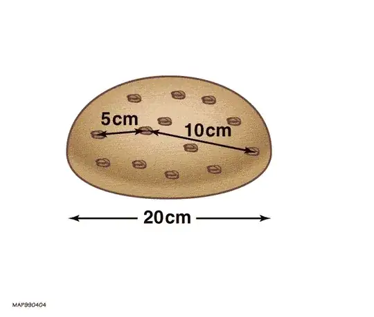

The simplest explanation relies on the statistical unlikelihood of us being at a special place and time in the cosmos. Let's say, for a moment, that we see galaxies moving away from us because of some cosmic explosion that set them in motion. In that case, we would expect to see the galaxies in one direction moving faster than the galaxies in another. Looking towards the center of the explosion, we would see galaxies on the other side moving much faster than if we looked in the other direction.
This, however, is not what we see. What we observe is all galaxies moving away from us, with a speed proportional to their distance from us. That means that the further away they are, the faster they are moving. It doesn't matter what direction we look in; a galaxy 500 Mpc away in one direction will have a recessional velocity approximately the same as one 500 Mpc away in the other direction.
This forces us into one of two conclusions: either we are at the exact center of the universe, which is statistically impossible, or space itself is expanding, so everything is moving away from everything else. The animation below shows how this would work. From any given point in space, it would look like everything is getting further away from you.
Explaining the recession of galaxies due to an explosion also raises many questions: What caused the explosion? Why would it start at one particular point? What were things like before the explosion? All of these are questions which do not have accepted answers. Instead, the expansion of space ties directly into the idea of the Big Bang. The expansion of space itself is what drove the Big Bang. It is not that the universe is expanding into something. Instead, space itself is expanding. However, the topic of the Big Bang is a different subject, so you can look up information on that yourself.

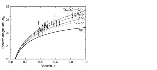

Supernova magnitudesThe best "proof" (in quotes because nothing is ever really proven in physics, only verified or falsified) of GR is given in Davis & Lineweaver (2004), I think. Because of the mechanism that makes supernovae type Ia explode, these objects are thought to reach a known brightness at their peak luminosity, and can thus be used as "standard candles". Plotting their magnitudes (in the $B$ band, taken from Perlmutter et al. 1999) $m_B$ vs. their redshift, the result can be compared to the predictions of various cosmological models. In the standard GR model, the result depends on the history of the expansion, which in turn depends on the densities of the various constituents of the Universe (baryons, dark matter, dark energy, radiation). This is the reason that SN1a can be used to constrain the densities of the components. In the special relativistic (SR) explosion model, however, the result only depends on the velocity of the emitter at the time of emission, and the velocity of the observer at the time of observation. Whatever happened in between doesn't matter (in this models nothing special happened in between$^\dagger$).
The result is shown in the figure below for various GR models (thin black lines) and for the SR model (thick black line). The SR model is ruled out at $23\sigma$.
Figure 5. from Davis & Lineweaver (2004).
$^\dagger$As the authors note, "1) SR could be manipulated to give an evolving Hubble’s constant, and 2) SR could be manipulated to give a non-trivial relationship between luminosity distance, $d_L$, and proper distance, $d$. However, it is not clear how one would justify these ad hoc corrections".
