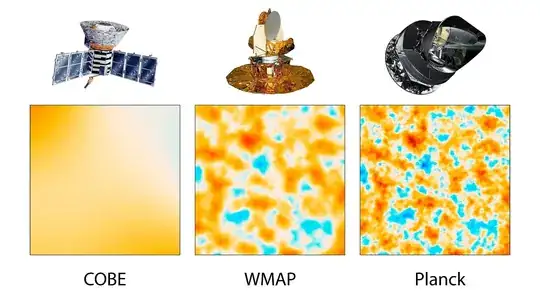

COBE, WMAP and Planck are all spacecraft that have measured the same cosmic microwave background (in increasing detail) from outside the Earth's atmosphere. The same background is found, with similar anisotropies, from different spacecraft using different telescopes, detectors and analysis techniques to remove non-cosmological sources.
