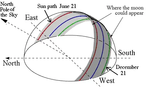

The Moon can appear in only about 48% of the sky* of a stationary Earth observer. The moon must be at least 61.4 degrees away from the celestial poles, such as the one near the North Star.
Compared with the sun, which must always be more than 66.6 degrees from the poles (40% of the sky), the moon has just a little more room to travel in the 'dome' of your sky, a little higher than the summer solar arc, a little lower than winter's.
To visualize what portion of your sky can have a moon in it, start by visualizing the celestial equator. That's the arc the sun appears to travel on the equinoxes. Here's that arc in the sky of someone at middle north latitudes.
The moon must be within about 28.6 degrees north or south of that equatorial arc.
The 28.6 figure adds the Earth's axial tilt - the famous angle between Earth's spin and orbit, 23.437 degrees - to the angle between the Moon and Earth's orbits, 5.145 degrees.
So imagine a 57.2 degree band across your sky (28.6 doubled), along the celestial equator. The sun is confined to a similar 46.9 degree band. Here's a visual for this kind of segment of your celestial sphere.
In this figure which I also just stole off the interwebs, the sphere does not represent Earth, it represents your sky, without the Earth in the way. O is you, call it the Observer, and the angle between the red lines is 57.2 degrees. And you need to imagine this tilted to the same extent as the equator in your sky.
This shows that at latitudes higher than 61.4 degrees (90 minus 28.6), the moon could appear anywhere on your horizon.
*48% is the sine of 28.6 degrees. That surprisingly simple calculation is the portion of the sky taken up by an equatorial band, based on the area of a spherical segment, $2\pi R h$ divided by the area of a hemisphere $2 \pi R^2$, which is $h / R$ or the sine of the angle. That's for a pole observer, but whether at the pole, the equator, or anywhere in between, you can see about half the band and half the sky.
