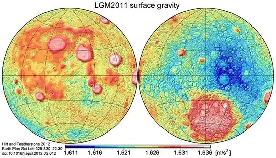

And it's worth adding that rocky worlds are gravitationally lumpy, where the heavier side (gravitational gradient), tends to, over time and in tidal locking, face the object it orbits. The near side of the Moon, for example, is slightly denser on average than the far side. See here for a better explanation and here for gravitational map of the moon (the Earth side is on the left in the picture below).
