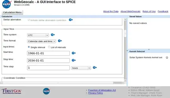

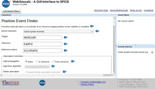

I hope to provide a better answer later, but for now:
enter image description here enter image description here enter image description here
and click "Calculate". This will tell you every time Mercury has an ecliptic longitude of 30 degrees, the cusp between astrological Aries and Taurus.
If you do this for all 7 planets and every multiple of 30 degrees (12*7 = 84 times), you can use the results to see when the combination of constellations change. However, this is has several problems:
  • It's extremely inefficient
  • If you hover over "Solar System Kernels kernel set" above, it says the kernels are valid from 1950 to 2050. However, with the options I chose, you can only get results from 1966 to 2034, possibly because the ECLIPDATE frame is only defined in that interval (when I choose years outside this range, I get an unhelpful and inaccurate error-- you may get different results for other planets).
  • The results are in calendar times; however, this may be my fault. You may be able to get the results in a more numerical and useful format.
The "correct" way to do this is to use CSPICE (http://naif.jpl.nasa.gov/naif/tutorials.html) which lets you make calculations +- 10000 years from now.
Leaving that aside, let's check our results. If you scroll down a bit in the results window, you'll see:
Let's check the result for 2017-04-20 by visiting http://ssd.jpl.nasa.gov/horizons.cgi and entering these parameters:
to get these results:
As you can see, Mercury's ecliptic longitude crosses 30 degrees between 2017-04-20 and 2017-04-21, so our results are reasonable. Interestingly, Mercury is in retrograde at this time, so it actually crosses from Taurus into Aries, not vice versa.
