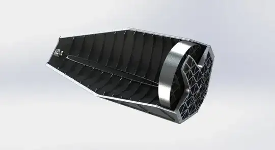

A rendering of the compact exoplanet imaging telescope Project Blue
above: "A rendering of the compact exoplanet imaging telescope Project Blue plans to launch into orbit and aim at Alpha Centauri. Credit Project Blue" from here.
It jumps out that the secondary is mounted off-axis, which can have mechanical and optical advantages (e.g. diffraction) but would probably limit the image quality to a narrow field of view, which might be OK for a single-target telescope if there are suitable calibration targets nearby.
