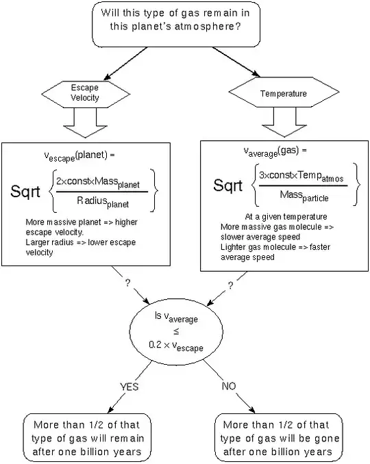

What determines how long a planet will keep its atmosphere is the strength of the planet's gravity versus the random thermal motion of the molecules in its atmosphere.
The atmosphere is a gas, and all gasses have molecules that move around with velocities that are dependent on the temperature. High-temperature gasses move faster, and low-temperature gasses move more slowly. Each molecule of gas will have a velocity $v_{\text{gas}, \text{average}}=\sqrt{\frac{3k_BT}{m_{\text{gas}}}}$.
In addition, each individual molecule is pulled to the Earth by gravity. Heavier gasses, such as water, carbon dioxide, and oxygen, are pulled more than lighter gasses, such as hydrogen and helium. The escape velocity of the planet is given by $v_{\text{escape}}=\sqrt{\frac{2GM_{\text{planet}}}{R_{\text{planet}}}}$.
If a gas molecule has a high enough thermal energy, then if it is at the top of the atmosphere, it could fly off into space, the thermal motion overcoming gravity's pull. The lighter it is, the less thermal energy it needs to have. Of course, this all depends on probability and statistics, but, in general, if $v_{\text{gas}}\ge0.2 \times v_{\text{escape}}$, that species of gas will be reduced to 1/2 its initial amount after 1 billion years.
Here is a flowchart describing whether or not a gas will escape.
