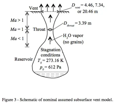

Possibility #3 Sub-surface Vent:
above: Figure 3 from Jared James Berg's thesis Simulating water vapor plumes on Europa.
Berg's thesis presents Direct Simulation Monte Carlo (DSMC) calculations for a scenario where a reservoir of trapped liquid water below the surface of Europa feeds a volume of water vapor which continuously vents to the surface. If the cross section of the passage has a constriction or narrowing followed by and expansion area, this forms a sort of nozzle which converts some of the random thermal motion of the atoms into a directed flow. The velocity will be somewhat focused upwards, and the magnitude will be of the same order as the thermal velocity.
This model does not rely on high pressures in the crust, but instead "focuses" the thermal motion upwards.
The simulation includes the dynamics small "grains" of water ice in addition to water vapor molecules. At some point early in the trajectory, the mean free path becomes so large that further condensation stops and molecules are traveling on nearly ballistic trajectories under the influence of gravity.

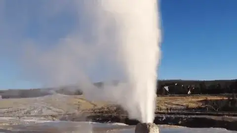

Yes if Europa had Earths atmosphere, the geysers wouldn't be there, but no, there aren't geysers on Europa because there's no atmosphere.
But this kind of calculation is an overestimate of the impact of drag. The effect in a real geyser would probably be much smaller than this kind of calculation suggests. Take a look at an actual geyser! The mass of the water probably dominates the column, and rapidly transfers momentum to the air in the column by the same drag force. The force ($dp/dt$) is equal and opposite, so actually drag may speed up the air much more than it slows down the water. And of course, this is hot air and steam which are accelerated by buoyancy forces as well.
The source is the following video - it really gets going around 02:00, and if you keep watching you can see a double rainbow as a bonus! (original)
https://www.youtube.com/watch?v=y8gLhHzPY5M
