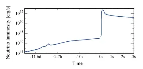

I think your best bet would be detecting neutrinos generated by nuclear burning inside the star (as we do for the Sun). Once the star hits the carbon-burning stage, it's actually putting out more energy in neutrinos than in photons. During the silicon-burning phase, which lasts for a few days and is what creates the degenerate iron core (that collapses once it is massive enough), the neutrino flux increases to about 1047 erg/s a few seconds before core collapse. (The peak flux during core collapse is about 1052 to 1053 erg/s). This paper by Asakura et al. estimates that the Japanese KamLAND detector could detect the pre-supernova neutrino flux for stars at distances of several hundred parsecs, and provide advance warning of a core-collapse supernova several hours or even days in advance. Since your characters are in the same system as the star, they'd hardly need a large underground detector to pick up the neutrinos.
This plot shows an example of neutrino luminosity (for anti-electron neutrinos) versus time for a pre-supernova star (from Asakura et al. 2016, based on Odrzywolek & Heger 2010 and Nakazato et al. 2013); core collapse begins at t = 0s.
Figure 1 from Asakura et al. 2016
By measuring the spectrum of energies for different types of neutrinos and their time evolution, you could probably get a very good idea of how far along the star was, particularly as we can probably assume your characters have much better models for stellar evolution than we currently do. (They'd also want to get accurate measurements of the star's mass, rotation rate, maybe internal structure via astroseismology, etc., in order to fine-tune the stellar-evolution model; these are all things they could do pretty easily.)
The core collapse itself would be signalled by the enormous increase in neutrino flux.

  • @RobJeffries Sure, but they'd need to detect these neutrinos before the major burst happens. What's more, who knows how far out the space ship is. – zephyr Sep 21 '16 at 16:39
    @zephyr From Table 6 of the paper I linked to, let's say KamLAND can detect pre-SN flux 10 hours before core collapse for a star 150 pc away (after a 48 hour integration). The neutrino flux for a spaceship 100 AU from the star is about 100 billion times higher. So, as Rob Jeffries pointed out, you could use a detector 100 billion times smaller than KamLAND. To cut the integration time to a more practical 1 second, you need a detector 500,000 times smaller than KamLAND: about 2 kg of liquid scintillator. (Assuming no better technology.) – Peter Erwin Sep 21 '16 at 17:01
