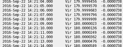

This doesn't answer your question, but has two screenshots, so that's something :)
If you run http://ssd.jpl.nasa.gov/?horizons with these settings:
part of the output looks like this:
This shows the Sun crosses the equinox point between the 8th and 9th second of 14:21 (which is 10:21 your local time). HORIZONS will even let you compute at half second intervals but not beyond that.
If you use the http://naif.jpl.nasa.gov/naif/tutorials.html library, you can compute the time down to the nanosecond or better, but this doesn't really help because we don't know the Sun's position, the Earth's position, or even the direction the North Pole is pointing to that level of precision.
So, not an answer, but some hopefully helpful comments.
