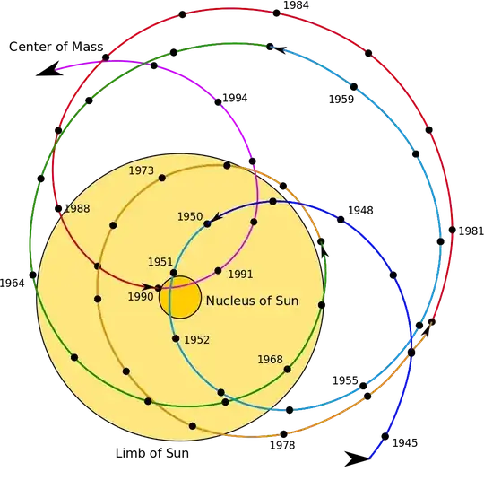

Neverthess, there is still a barycenter (often outside the limb of the Sun) about which the Sun does a complex dance.

The barycenter of our solar system is the combination of all it's masses, this is how much the sun wobbles:
Solar System Barycenter
