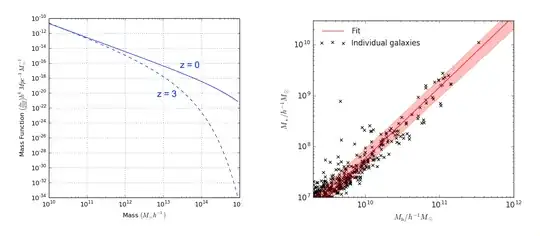

Galaxies have their origin from the clumps in the almost smooth primordial soup of gas and dark matter (and radiation). These clumps have a size distribution — the halo mass function — which is a power law at small masses and with a exponential cut-off at large masses. Thus, the size of galaxies follow a similar distribution.
The figure on the left below (created with this tool) shows the distribution of dark matter halos, i.e. number per volume at a given mass today (redshift $z=0$, solid line) and when the Universe was only two billion years old ($z=3$, dashed line). You can see that in early times, the large halos hadn't formed yet.
The figure on the right (from my own cosmological simulation) shows how many stars there are in a (simulated) dark matter halo of a given mass. You can see that it follows an approximate power law, but with quite some scatter.
