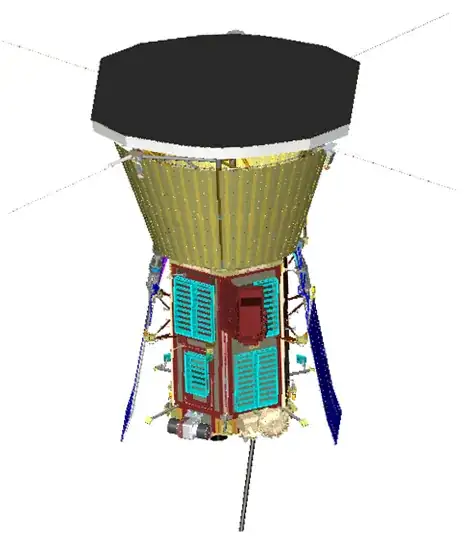

illustration of NASA's Solar Probe Plus from http://solarprobe.jhuapl.edu/spacecraft/
above: illustration of NASA's Solar Probe Plus from http://solarprobe.jhuapl.edu/spacecraft/ Sun is up - to state the obvious!
