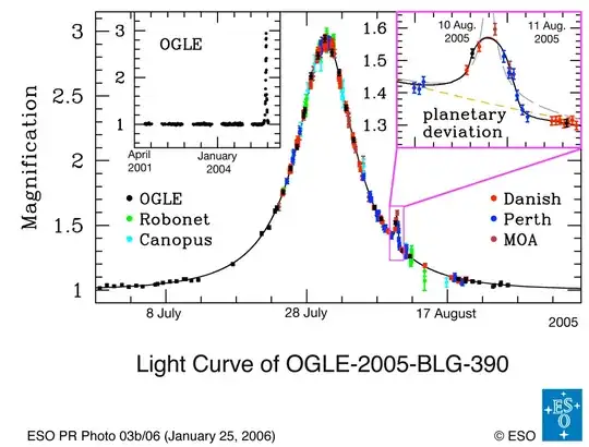

  1. Microlensing - This uses the concept of gravitational mass acting as a lens to background, luminous objects by bending spacetime, and consequently, the path of light through space. If a planet passes in front of a background object (not its host star), it will cause a slight magnification of that background object. I should say that this requires a chance alignment and so it is not a repeatable measurement, meaning there is often little chance that we can actually confirm that we saw a planet. Below is a light curve of a background object and you can see it grow brighter as the main star passes in front of the background object. Pay attention to the little blip on the right which indicates the planet also passes in front of the background object.
