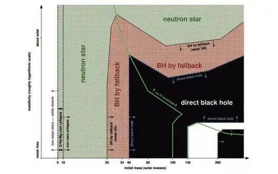

A succinct summary of supernova types is given in the following image based on Heger et al. (2003):
Image courtesy of Wikipedia user Fulvio 314 under the Creative Commons Attribution-Share Alike 3.0 Unported license. The graph is based on the graph in Fig. 1 of the linked paper.
The pair instability realm is upwards of ~100 solar masses, though it is metallicity-dependent (Question 3). As Figure 1 (below) shows, neutron stars form in the mass range of >9 solar masses - again, this is metallicity-dependent (Question 1a). Starting at around 25 solar masses, black holes will form (Question 1b).
It is thought to be possible for a black hole to form without a supernova (see the section of the graph marked "direct black hole"). This has not been confirmed observationally, although there are some possibilities. I've written about this in more detail here.

    I'll just add that the plots above show that there is indeed the possibility that a star might directly collapse to a black hole. It is labelled "direct black hole" in the second plot and is just marked as black in the first plot. Only the black holes by fallback are the result of a core-collapse supernova. A type Ia supernova is a thermonuclear detonation; nothing gets left behind. The recent GW discovery of merging 30 solar mass black holes may be the first evidence for direct collapse black holes, since fall back BHs are unlikely to be so massive. – ProfRob Apr 27 '16 at 18:45
