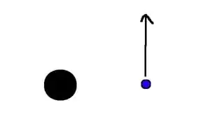

Consider first an object with velocity, and no gravity in action:
escaping?
Then, that blue object will become more and more distant, if it continues in the same direction.

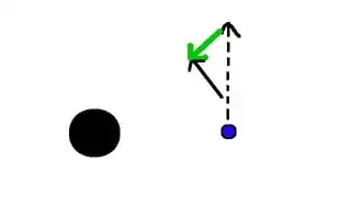

But it does not continue in the same direction, after a while, the gravity of the big black object has changed its course:
new course

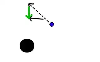

That happens again, and again and again:
repeat
Your question is: Why does not the object spiral in? You are perhaps thinking that as it comes closer, the gravity becomes stronger, and therefore the object is forced to come even closer.
But when it falls closer, its velocity increases. As we have seen, the velocity of the objects tries to make it escape. So when it is closer, it has more velocity to counteract the increased gravity.
