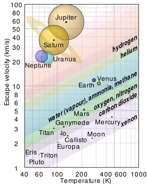

That depends on the size (mass/escape velocity) of the planet. See atmospheric escape and pretty picture
https://upload.wikimedia.org/wikipedia/commons/thumb/4/4a/Solar_system_escape_velocity_vs_surface_temperature.svg/512px-Solar_system_escape_velocity_vs_surface_temperature.svg.png
For the 4 inner planets, the solar wind strips gas from the planets. This process if fairly straight forward. It has more to do with heat than traditional "blowing", and when the when the outer atmosphere gas molecules reach a certain temperature they can achieve escape velocity. Earth mostly just loses hydrogen and helium and very little of it's heavier gases. Venus over time has lost most of it's Methane and Water Vapor, the key difference between Earth and Venus is that Earth has a magnetic field.
Mars has lost most of it's atmosphere and what atmosphere Mars retains may be related to the thawing and re-freezing of it's icy poles, and Mercury's atmosphere is so thin that it's atmosphere actually is little more than a loosely retained collection of solar wind particles.
The 4 outer planets don't lose much to the solar wind and the Solar wind (I would think) adds to rather than takes away from their total mass, but this addition is very small compared to the mass of a planet.
