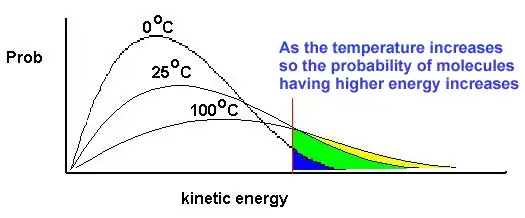

  • A small fraction of the gasses of the atmosphere exceed the escape velocity of Earth at any given time. Over time, many of these gasses get bombarded by high energy photons (as well as other particles) and fly out of Earth's gravitational potential well. If there are no other sources of these lighter gasses then there is a net loss.
maxwell-boltzmann
Temperature does play a key role here (as the above plot suggests), but regardless, this process works to reduce the amount of atoms and molecules in the atmosphere (and it affects smaller mass atoms/molecules more so than heavier ones - this is why the Martian atmosphere is primarily carbon dioxide. Essentially it wasn't massive enough to be able to hold on to its lighter gasses, and over time the vast majority of them escaped).
