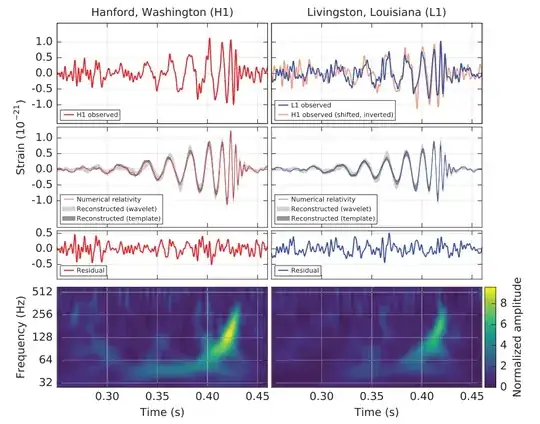

This image from the paper in Physical Review Letters (not behind a paywall) is a better summary of what LIGO heard than the current accepted answer. I'll explain the panes from top to bottom.
  1. The top panes show the 'raw' signals measured in the two detectors with the H1 data overlayed on the L1 data on the right.
  2. The second row of panes shows a number of different simulations of what general relativity (Einstein's theory) predicts for the gravitational waves. These simulations are how LIGO is able to claim that they know that the wave was caused by two merging black holes.
  3. The third row of panes is the 'raw' data minus the simulations.
  4. The bottom panes are simply another way of plotting the 'raw' data called a time-frequency plot. Time is on the x axis and frequency is on the y axis. To a person from the field this signal is the most recognizable characteristic of a merger, known as a chirp. As time moves forward, the frequency shifts higher. You can actually listen to the 'raw' chirp here.

    Can you explain why the H1 observation in the upper right plot is marked as "inverted"? I haven't seen anywhere else before remark that H1 is inverted, but I can clearly see that is the case. What's the reason for this? – zephyr Jun 05 '17 at 13:16
  • @zephyr: The two detectors are oriented differently (Hanford NW/SW, Livingston WSW/SSE), that might be the reason; I’m just guessing, though. – chirlu Jun 06 '17 at 07:43

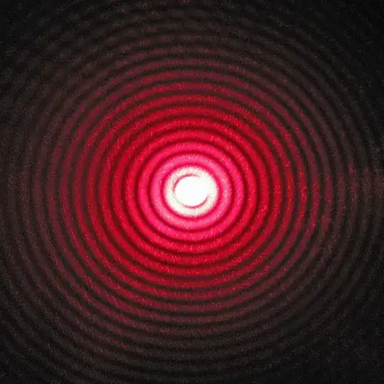

The actual mechanism of measurement that LIGO used is laser interferometry, so one reasonable interpretation of what LIGO "saw" would be the interference pattern caused by the gravity waves, which would "look" something like this:
Unfortunately I could not find an image of the actual laser interference that LIGO mentioned; it's probably too small for photography anyway.
All the other graphs people are linking do are just graphs of the interference pattern data. Showing a graph of the LIGO data as an answer to this question is like showing an image histogram as an answer to the question, "What does the Hubble space telescope see?"
user151841
  • 253
    This is actually the interference pattern of two overlapping laser beams with different curvatures, and is what one might expect to see in a cheap interferometer (see e.g. Newton's rings). However, LIGO has incredibly well made mirrors so the interference at the output of the detector does not have any rings, and, in fact, is completely black on the scale of this image. – Chris Mueller Feb 18 '16 at 12:46
