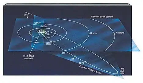

There's a great deal of variation with individual comets life spans though. For example, a Halley-type orbit (see picture) doesn't cross Jupiter's orbit due to the 18 degree inclination, but Halley type comets are more rare (75 known per Wikipedia article above). Jupiter family short period comets are more common (511 known), and those are also more likely to get jostled by Jupiter since they cross Jupiter's orbit.
Source of picture here.
