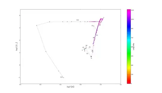

Is there graphic of typical temporal paths that stars take through the Hertzsprung-Russell diagram?
oasis
  • 81
This is typically a bit tricky to show because (1) some phases (e.g. the main sequence) are much, much longer lived than other phases and (2) a number of phases are spaced very close together in HR-space.
Be that as it may: any elementary text book on stellar structure will guide you through the path of a star through the HR diagram, usually accompanied by pictures. The book by Prialnik on this subject matter, or Ostlie & Carroll, are both excellent.
Here is a very crude version of the temporal path through the HR diagram I made some time ago. Numbers show the different phases (2 is MS), colorcoding shows the ages.enter image description here

  • And let me just note that this Figure will look different for stars of different masses (and metallicities). This was for a solar metallicity, 2 solar-mass star. – user1991 Dec 21 '15 at 11:13
