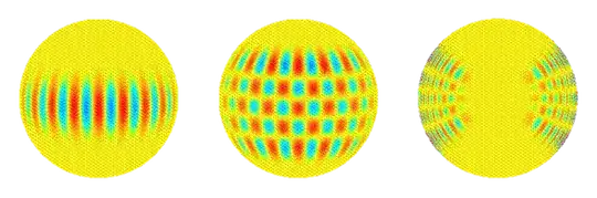

The three different kinds of waves that helioseismologists measure or look for are: acoustic, gravity, and surface gravity waves. These three waves generate p modes, g modes, and f modes, respectively, as resonant modes of oscillation because the Sun acts as a resonant cavity. There are about 10^7 p and f modes alone. [Harvey, 1995, pp. 33]. Each oscillation mode is sampling different parts of the solar interior. The spectrum of the detected oscillations arises from modes with periods ranging from about 1.5 minutes to about 20 minutes and with horizontal wavelengths of between less then a few thousand kilometers to the length of the solar globe [Gough and Toomre, p. 627, 1991].The image below was generated by the computer to represent an acoustic wave ( p mode wave) resonating in the interior of the Sun.
The figure above shows one set of standing waves of the Sun's vibrations. Here, the radial order is n = 14, angular degree is l = 20, and the angular order is m = 16. Red and blue show element displacements of opposite sign. The frequency of this mode determined from the MDI data is 2935.88 +/- 0.2 microHz.

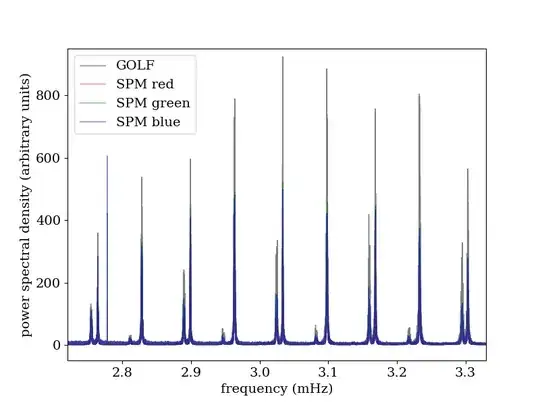

The wikipedia webpage on Helioseismology offers this power chart:
