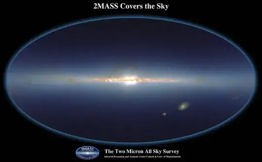

The Milky Way is a flat disk
The first one, and the simplest one, is that we live in a disk. As you can see on images like the ones from the 2MASS survey in the infrared range: enter image description here
We clearly see that we are inside a disk, since what we see when we look around us is a disk seen edge-on. It does not look like an ellipsoid or any other shape; it looks like a disk.

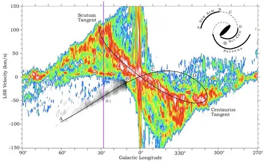

The other strong clue we have is the velocity of stars of the Milky Way, we can measure. First, we see an overall rotational motions, and, when you look closely to the patterns (like in the following image, that is observations in the radio range of the Milky Way at Green Bank Observatory), you can deduce that stars are even ordered into spirals: enter image description here

  • The second picture is very compelling...but I still don't get it, the black line of A-B-C-D doesn't really follow any real pattern (A-B yes, but then the pattern of the large red unlabeled splotch really doesn't look like it wraps around like that. I just don't really see it. Can you be more explicit? – Mitch Harris Dec 23 '13 at 22:30
    @MitchHarris: It's not a 2-D spatial map, it's a plot of velocity vs. galactic longitude. A spatial map is shown in the upper right corner, with segments A-B and C-? corresponding to what appear to be two subsets of the same spiral arm (with B-C-D apparently blocked from our view by the core). – Keith Thompson Dec 24 '13 at 00:22
    Note that the map in the second figure is actually radio emission from gas clouds, not stars, so it's really telling you that the (neutral hydrogen) gas in the Milky Way disk is organized into spiral arms. – Peter Erwin Jul 03 '15 at 20:48

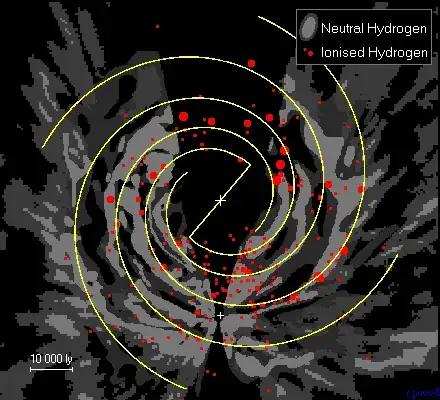

In addition to @MBR's answer; there are other (less confusing) ways to represent the data. This paper describes the method used; basically they plot the position and motion of the stars, or of hydrogen clouds. The hydrogen distribution of our galaxy looks like this:
hydrogen map of the Galaxy
Now there's a lot of noise in these measurements, but generally you can see that the hydrogen clumps together in spirals.
