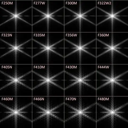

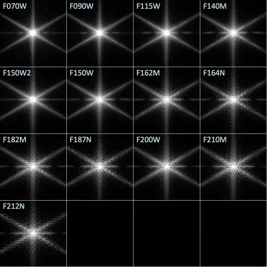

The JWST images will have various artifacts. I found a web page that summarises the situation for the Near Infrared Imager and Slitless Spectrograph (NIRISS).
The image below (taken from that webpage) shows simulated point sources as they would appear on the detector (including the sampling by the 0.0656 arcsec pixels). The greyscale is on a logarithmic scale of brightness. Each postage stamp corresponds a 77x77 pixel region around the point source, imaged through filters at different wavelengths (identified by the code in the top left, where 090 corresponds to 0.9 $\mu$m etc. and the W or M corresponds to wide-band or medium-band).
NIRISS simulated PSFs, with 0.0656 arcsec pixels JWST NIRISS PSFs
Then there is a further web page that gives the equivalent information for Near Infrared Camera (NIRCam), which has a short-wavelength (SW) and long-wavelength (LW) channel, as well as several filters associated with each of these.
NIRCam SW simulated PSFs, with 0.031 arcsec pixels NIRCam  SW PSFs
NIRCam LW simulated PSFs, with 0.063 arcsec pixels NIRCam LW PSFs
