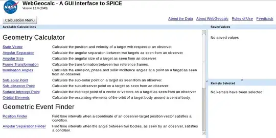

When you first visit WebGeocalc, you will see something like this:

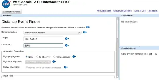

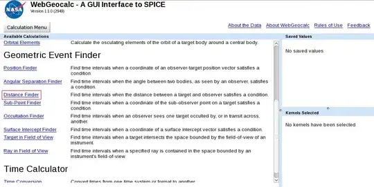

Because you are looking for perihelions, which involve distance, scroll down and choose "distance finder":
Since you want to find the perihelion of Mercury, fill out the top half of the form like this:

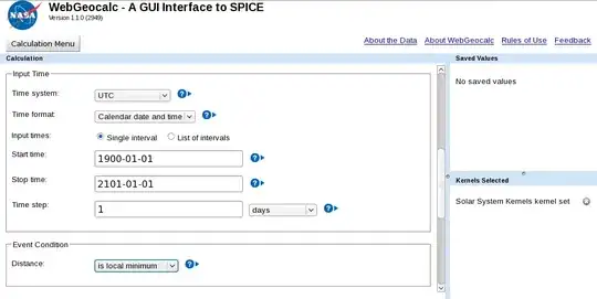

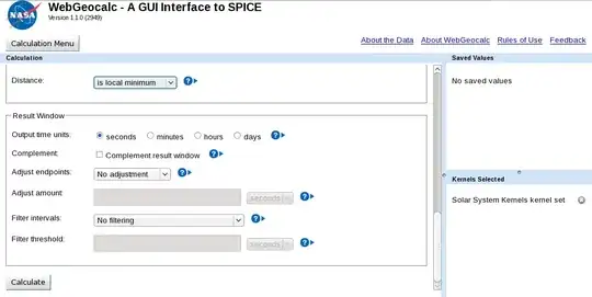

For this example, I'll find all perihelions from 1900 to 2201. A perihelion is a minimum of distance, and since you're looking for all perihelions, choose "is local minimum" on the lower half of the form, so it looks as follows:

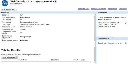

Scroll down once again (you can leave the remaining form values as is) and click the "Calculate" button:
When you get your results, click "Save All Intervals" to save the times of Mercury's perihelions. Note that each result is an interval, but the interval is 0 seconds long, so it's actually a point in time:

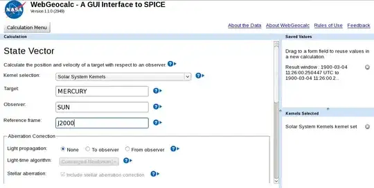

To find Mercury's position at these times, first click on "State Vector", which will take you to a form. Fill out the top half of the form as follows:
Fill out the lower half of the form as follows, dragging the results window (for the times of Mercury's perihelions) into the input times window:

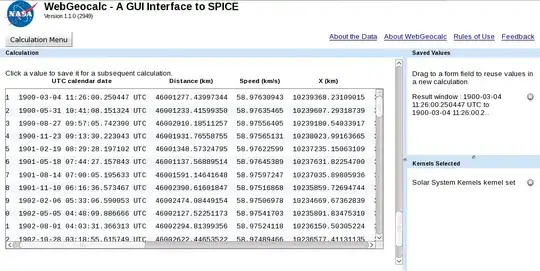

Click "Calculate" to receive your results:
