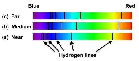

  • Now look at the sky. Pick any bright dot, run its light through a prism, and knowing that it is also made of roughly 75% hydrogen and 24% helium compare its spectroscopic signature to the bands you obtained earlier.
Because of the Doppler effect caused by the expansion of the universe the light waves are stretched, making the frequency drop - shifting the whole spectroscopic signature towards lower frequencies. The further the object is, more noticeable the shift towards red is.enter image description here
Thus, the term Red Shift.
Now, answering your question:
How do we know that its not just red light from red stars?
Because even regular light from red stars will shift towards the infrared side of the spectrum as a consequence of the Doppler effect.
