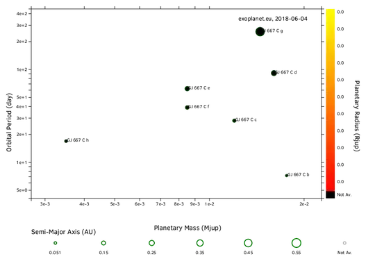

If you use the variable star_name="GJ 667 C" for the search term on the webpage: http://exoplanet.eu/diagrams/ you can create this:
Plot of GJ 667 C Planet's Mass and Radius

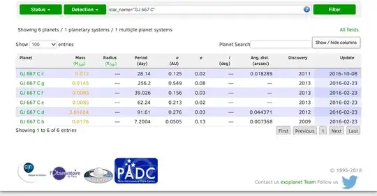

Use the search bar at the URL: http://exoplanet.eu/catalog/ for this result:
Catalog of GJ 667 C's Planets
