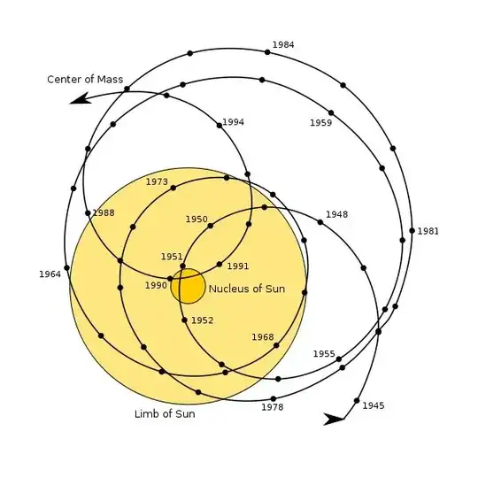

The image below might be helpful. It shows the track of the solar system centre of mass compared with centre of the Sun over a period of several decades. Notice how the Sun executes a complex trajectory (with respect to the solar system centre of mass) that is mainly caused by the orbit of Jupiter, but then there are smaller, superimposed, signals caused by the smaller planets. In principle, if you observed for longer than the period of Neptune and had a detector which gave perfect measurements, you could reconstruct how many planets there were in the solar system, what their orbital periods were (and then from Kepler's 3rd law, what the planet-star sepration was) and what their masses were (multiplied by the inclination of their orbits with respect to the line of sight of observation, which is generally an unknown in doppler measurements).
Motion of the Sun relative to the solar system barycentre

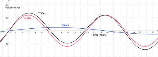

Below I simulate what the doppler signal due to these two planets would be. I hope you can see that the overall signal consists of the superposition of two sinusoidal signals with different periods and amplitudes. Myriad computational tools are available to do the fourier decomposition to establish these.
Combined doppler signal due to Jupiter and Saturn

  • Nitpick: Doesn't that first image show that the center of mass of the solar system takes a complicated trajectory, relative to the reference frame of the sun? As opposed to it showing that the center of the sun takes a complicated trajectory (relative to what reference frame I don't know). – zibadawa timmy Jun 06 '15 at 09:27
  • @zibadawatimmy Yes, you are correct - I didn't look closely enough at it. Obviously it has the same consequence. – ProfRob Jun 06 '15 at 10:16
