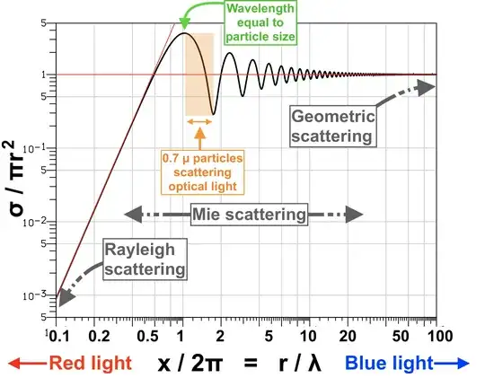

Scattering cross section
Scattering of light of wavelength $\lambda$ on particles of radius $r$ may be described in general using Mie theory. Using the variable $x \equiv 2\pi r/\lambda$, the scattering cross section $\sigma$ increases steeply with $x$ until $x\sim2\pi$, after which it decreases again and starts to oscillate, as seen in this figure:
scat
Scattering cross section (normalised to the geometrical cross section) as a function of particle size-to-wavelength ratio (from Wikipedia with my own annotations).
In other words, when a particle is much smaller than the wavelength of the light ($x\ll 1$), the probability of scattering the light increases steeply with decreasing wavelength — in fact the cross section goes as $\lambda^{-4}$. This regime is called Rayleigh scattering. The scattering efficiency reaches a maximum for particles roughly equal to the wavelength of the light ($x\simeq2\pi$; green arrow in the figure). Hereafter, it falls again, exhibits some oscillations that have to do with interference in the particle, slowly converging to the "geometric" value $\sigma = \pi r^2$ (i.e. what would be expected classically).
In many (astrophysical) situations dust tends to be a distribution of sizes with more small than large particles (typically $n\propto r^{-3.5}$), meaning that an ensemble of dust has much more particles that scatter short wavelengths (blue) than long wavelengths (red). Thus, blue light is filtered out and red light light tends to be transmitted, in effect reddening the light.
On the other hand, if the dust consists of particles of the same size, then the extinction may rise and fall with wavelength, as seen in the figure. For example, optical light with $\lambda \simeq [0.4\text{–}0.7] \,\mu\mathrm{m}$, scattered by particles of size $0.7\,\mu\mathrm{m}$, is scattered according to the orange region in the figure — i.e. red light is scattered more efficiently than blue light. The exact form depend on the refractive index of the scatterer.

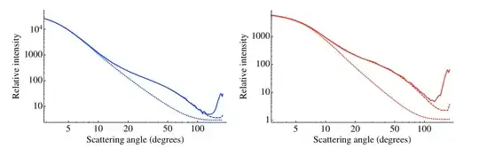

Blue halo and red sky
The unusual size distribution of the dust particles described above is the reason for the blue disk of the Sun, but cannot explain the blue halo around it (Ehlers et al. 2014). This spectacular phenomenon is caused by the difference in the phase function described above: Whereas Rayleigh scattering is rather isotropic, Mie scattering tends to scatter in the forward direction, and Martian dust in particular has a large asymmetry parameter (e.g. Vincendon et al. 2007), meaning that light that is scattered has a preference for being scattered along the LOS, i.e. toward the observer of the sunset.
Moreover, the asymmetry parameter is dependent on the wavelength of the light, with the forward scattering of blue light being much more pronounced than for red light, as seen in this figure:
asym Probability of scattering at a given angle for blue light (425 nm, left) and red light (694 nm, right). The three line types correspond to different models (from Ehlers et al. (2014)).
Hence, the red light has a larger tendency to be scattered out of the LOS, creating the reddish sky.

  • re asymmetry parameter: https://i.stack.imgur.com/ES3c1.png from http://hyperphysics.phy-astr.gsu.edu/hbase/atmos/blusky.html However I don't understand your argument how using the term means the forward scattered light is a different color. It may be in that reference but it's pretty deep. Why exactly is forward-scattering from red dust bluer (less red) than large angle scattering?? – uhoh Jan 20 '19 at 02:16
    @uhoh That was bad phrasing from my side. Forward scattering makes the halo more pronounced, because the light is not scattered so far from the LOS to the source, not more blue. The blueness is caused by the preferential scattering of red photons, i.e. they may be scattered multiple times and are hence lost, whereas blue photons are scattered perhaps ~1 time, and hence are still seen roughly along the direction toward the Sun. Thanks, I'll edit. – pela Jan 20 '19 at 14:26
    @uhoh It looked a bit more into this, and in fact the dust both preferentially scatters red photons and does indeed forward-scatter blue photons more than red photons. The preferential scattering of red photons doesn't have anything to do with the dust being red, but with the fact that it's mostly micron-sized particles. I updated the answer. – pela Feb 01 '19 at 10:55
