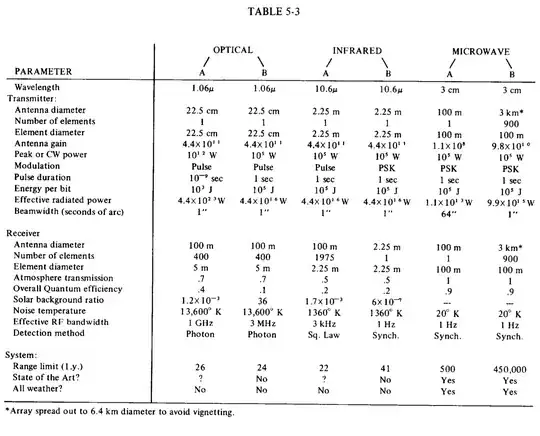

This table from page 50 of the well-worth-reading Cyclops report shows that a single $100~ \mathrm{m}$ transmitter/receiver combination, with a transmission power of $10^5~\mathrm{W}$, could function at a distance of 500 light years.
Building bigger transmitters and receivers will increase the maximum distance of communications. So will increasing the transmission power, pulse duration, and pulse interval. Current technology could let us communicate over tens or hundreds of light years. To communicate further, just build something bigger. The laws of physics place few limits on the distance we can communicate.
