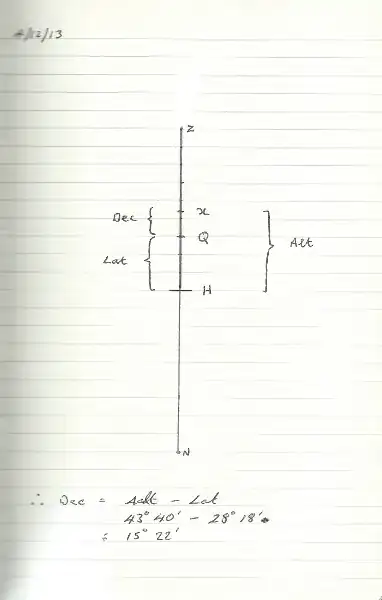

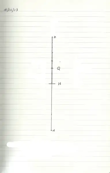

The first stage is to take a piece of ruled or graph paper and near the middle mark a short, horizontal line. This is your horizon, and is marked 'H'. Now draw upwards 9 lines and mark the top ,'Z' and downwards 9 lines and mark the bottom 'N'. You should end up with something that looks like this:-
Which is, basically a picture of your meridian as you sit and gaze south at it. 'Z' is your zenith, the point above you in the sky and 'N' is the nadir, it's opposite out on the celestial sphere through the earth beneath your feet.
Now we need to add a little more detail. Imagine that the celestial sphere is actually a glass sphere surrounding the earth with the stars and stuff stuck to it that we can project anything we want on to (we'll ignore porn and coke adverts for now), where would the celestial equator show and where would it go on our picture of the meridian? Well, it would be a distance above the horizon equal to our latitude (lets round it off to 30°), so we now have:-
Now we put in the body we are looking at. We know it's elevation, just over 43°, we can just call it x as you didn't specify a body. We can also label some of the distances we know, to end up with:-
We already knew that Lat was H -> Q, that's how we place Q, we know that elevation, or altitude is between the horizon and the body and that declination is measured from the celestial equator. We want to find dec and the diagram shows us that:-
dec = Alt - Lat
    = 43° 40' - 28° 18'
    = 15° 18'N
As 'x' is to the north of 'Q', then Declination is north.
