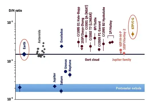

The key finding why we think Earth's water came from Asteroids (big rocks) and not Comets (small rocks) is the Deuterium/Hydrogen ratio that we can measure in several sources.
When a star forms, it has an initial value of D/H that came from the nucleosynthesis in its progenitor nebular / star.
In a protoplanetary disc, as dust grows to rocks grow to planets your nebular gas will be trapped with initial D/H ratios in gas giant atmospheres. But the way to get Water onto Asteroids and Comets (those don't have substantial mass to retain atmospheres themselves!) is sublimation and maybe adsorption.
The latter two processes are strongly sensitive to the gas-mass and therefore different D/H ratios from the protosolar ones are expected. And in fact we find them to be different:
D/H ratios from various sources in the solar system
This was in the news lately, as ESA managed to touch down and measure 67P's D/H ratio which gave another hint on the asteroidic origin of water on earth.
